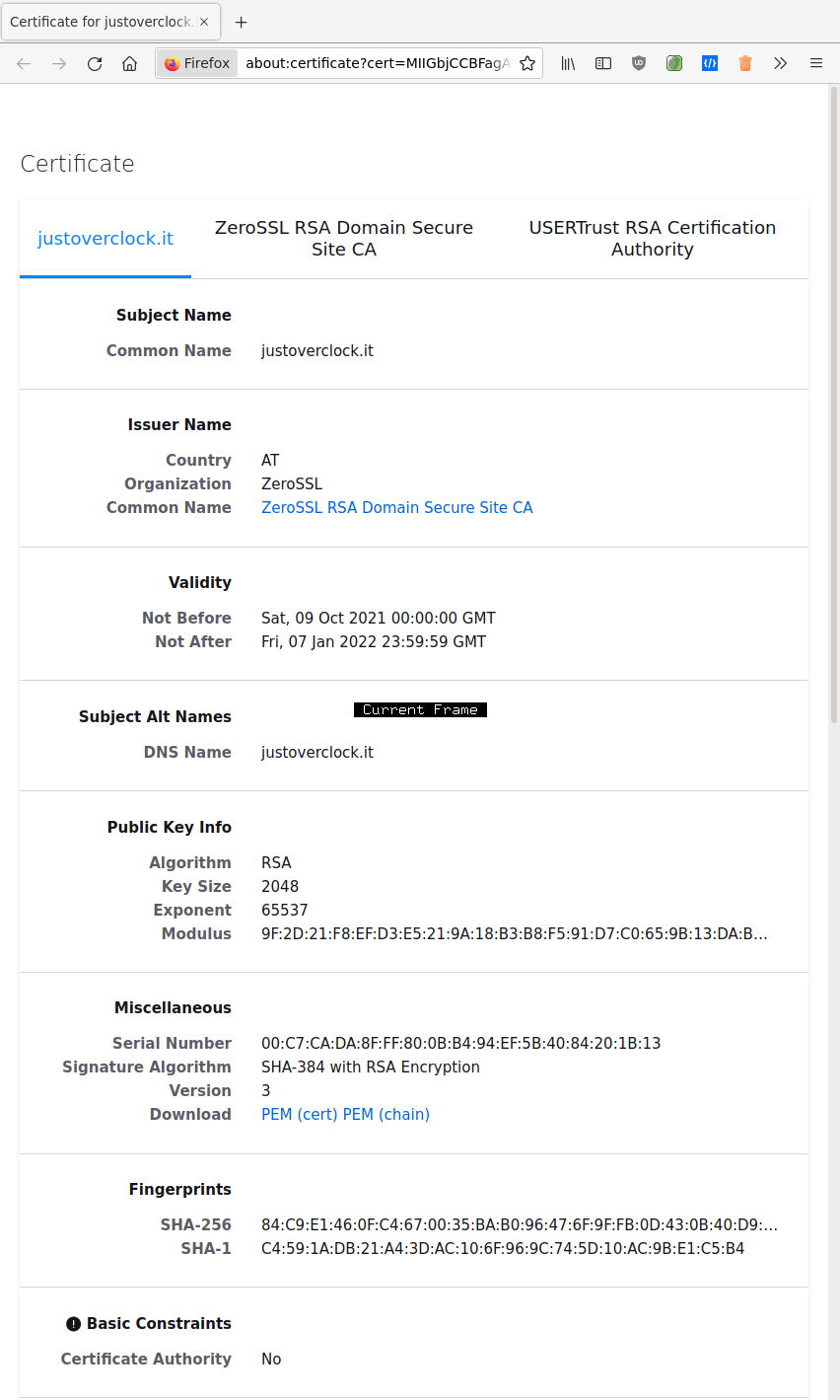

    @justoverclock said in Digitalocean Ubuntu configuration:
    my website justoverclock.it seems work only without www
    Seems you are using HSTS (HTTP Strict Transport Security) but your webserver’s certificate does not include “www.justoverclock.it” in the Sub Alt Names section:
    Solution is to either have another cert generated that does or not use HSTS.
    I use Let’s Encrypt and previously unfamiliar with ZeroSSL. Seems they may be repackaging Let’s Encrypt to be more available/accessible to non expert types. In which case I expect you should be able to regenerate the cert to include subject alt name for “www” variant and be good to go.
    Edit: I guess a third option might be to remove the www A record and live without it but then that kind of sucks because some browsers prepend it whether user types it in or not.

    @gotwf I’m looking at this now. The WWW record is there, but the cert doesn’t cover it as you’ve pointed out. I guess we could just place a redirect at Apache or NGINX level to get around this.

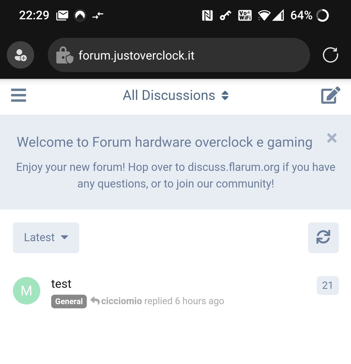

    @phenomlab yep sure, now i’ve just noticed that forum.justoverclock.it is not reacheable on my phone but works on my pc…
  • @phenomlab yep sure, now i’ve just noticed that forum.justoverclock.it is not reacheable on my phone but works on my pc…
    @justoverclock works fine on my phone.
  • @justoverclock works fine on my phone.
    @phenomlab is a mystery…on my iphone does not work…and i’m on the same wifi of my house
  • @phenomlab is a mystery…on my iphone does not work…and i’m on the same wifi of my house
    @justoverclock does it work on 4g ?
