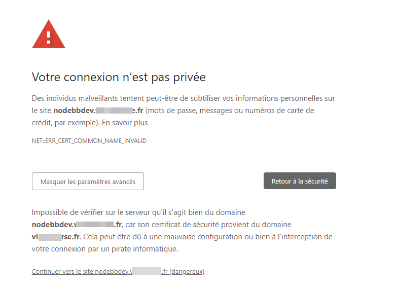

    Your connection is not private
    Malicious individuals may be trying to steal your personal information from the nodebbdev.xxxxxx.fr site (passwords, messages or credit card numbers, for example). Learn more
    NET::ERR_CERT_COMMON_NAME_INVALID
    I can Bypass the message but that’s not the goal

    It is impossible to verify on the server that it is indeed the domain nodebbdev.test.fr, because its security certificate comes from the domain test.fr. This could be due to a misconfiguration or your connection being intercepted by a hacker.
    Seems to be a configuration problem but don’t know where and why ?
    I have installed the ZeroSSL CA certificate on domain and nodebbdev subdomain.
    @DownPW it looks to me that the cert you are using isn’t a wildcard or for the subdomain.
    d**n, maybe you are right because I’m on a ZeroSSL free account
    But I can normally generate a certificate for all subdomains. I didn’t get this message before.

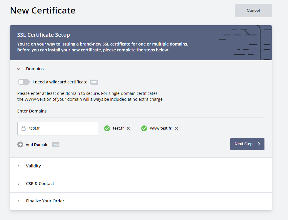

    @DownPW how are you generating the certificate?
    like this
    replace test.fr with my domaine of course. (not subdomain)
  • like this
    @DownPW yes, you need a wildcard cert for the subdomain to work. Can you use LetsEncrypt?

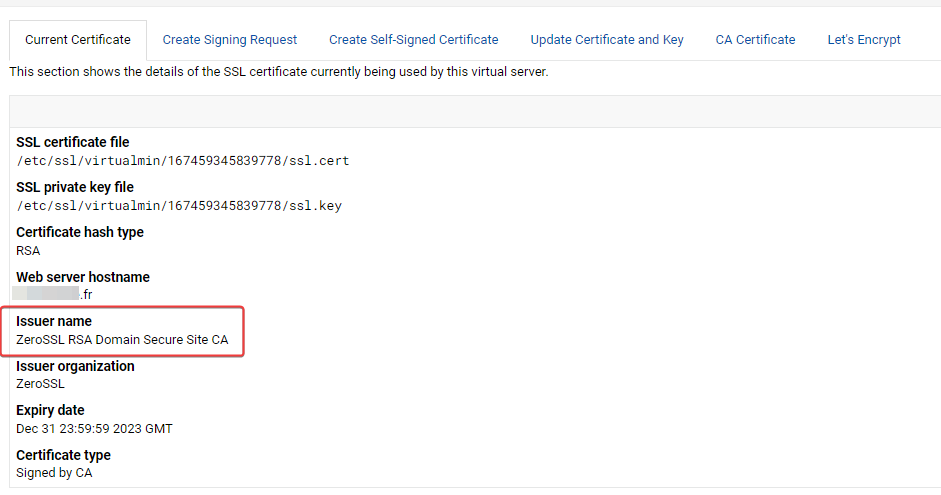

    I have regenerate with certbot, reload nginx without errors but it is still the zeroSSL certificate that appears in Webmin/Current Certificate

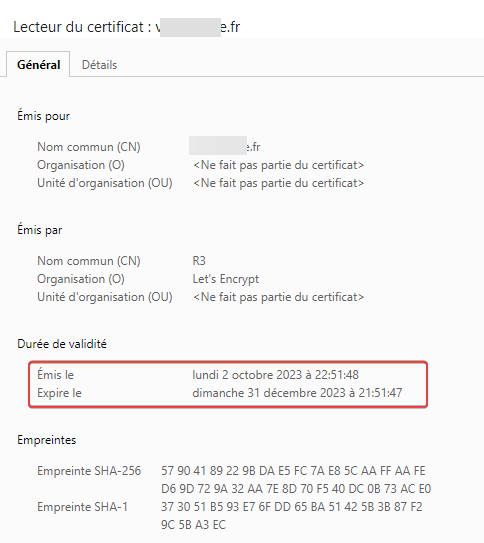

    EDIT : Very Strange, i test again to regenerate certificat with let’s encrypt on virtualmin and that’s work and Current certificate is now OK on virtualmin.
    it never worked for several months and it works now, very strange 😲
