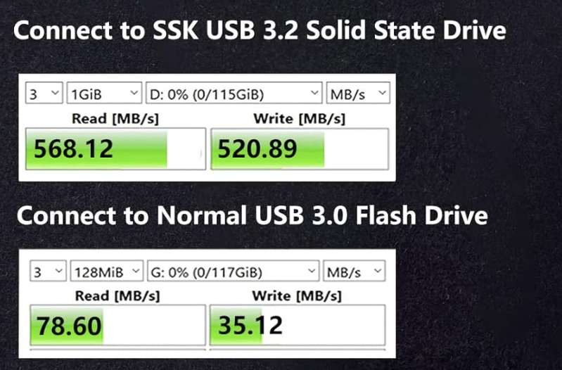

    @Madchatthew Great overview, thanks. I too have done something similar (although not for a few years), and it’s a great way to be completely secure in the sense that if you need to use a public computer, you simply restart it with the USB drive attached. I’m inclined to do this again, and would probably go for a USB stick like the below
    https://www.amazon.co.uk/SSK-External-Android-Business-Essential/dp/B0C36CXVP4
    The difference in read/write speed is significant

    @phenomlab That is awesome! I just used a 32 G stick because that is all I had. A 256 MB one would be way better and probably all you would need. It would be kinda fun to go up to 1 TB, but I don’t think you would need that size for this application.
    I love how you can use either end. One for regular USB and the other for USB C. That is great and the price is actually pretty good. I looked at the 1 TB and the price wasn’t bad even for that size.
