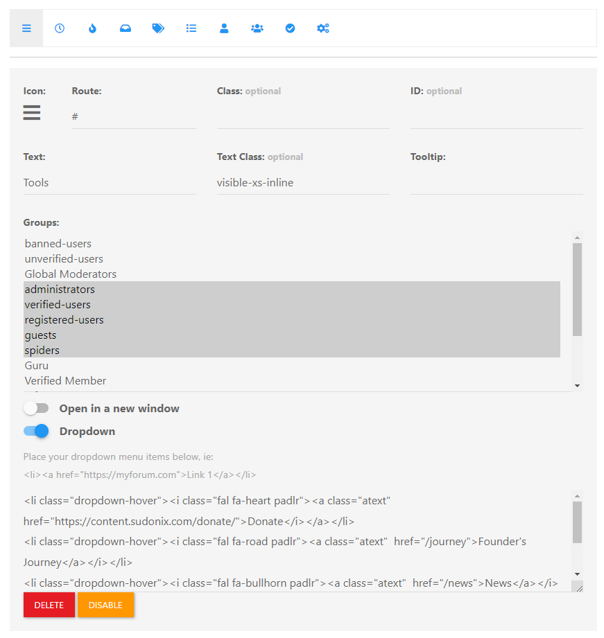

    What do I write in these fields to create a drop-down menu in NodeBB?

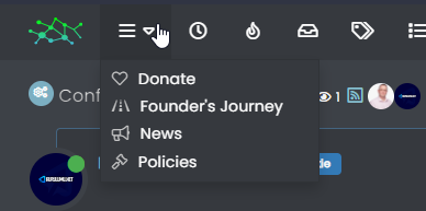

    @kurulumu-net You set it like the below example taken from this site
    Which presents this
  • @kurulumu-net You set it like the below example taken from this site
    Which presents this
    @phenomlab I found why I can’t add list items. Turns out you had to click the activate button first.
  • @phenomlab I found why I can’t add list items. Turns out you had to click the activate button first.
    @kurulumu-net Yep 🙂
