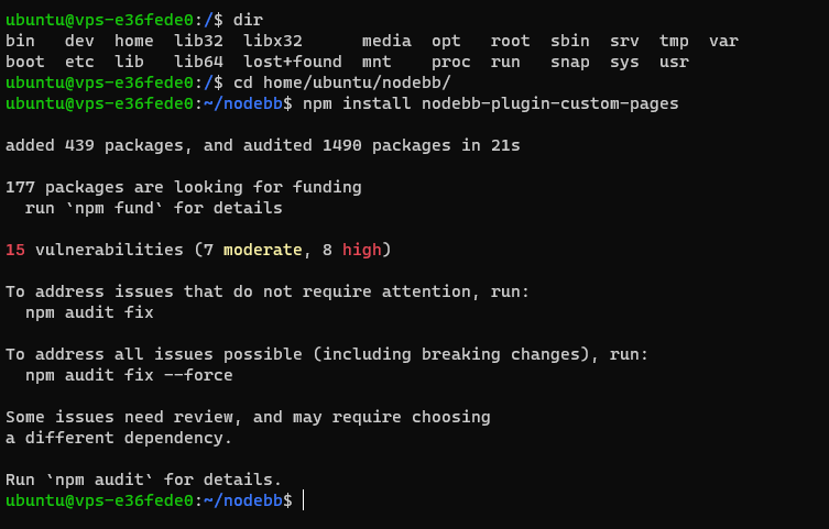

    @mventures It’s not as difficult as it sounds. You just need to gain access to your server via SSH (see https://sudonix.com/topic/445/nodebb-upgrading-to-nodebb-v3-x/6?_=1680448676890) then ensure you are in the NodeBB directory.
    From there, you can issue that same code, for example
    As you can see from the above, I’ve now installed this on your forum. From here, you’ll now need to activate the plugin before you can use it

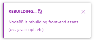

    Click Confirm. After a few seconds, NodeBB will tell you that the plugin has been activated, but you need to rebuild and restart before it will work
    Now you need to rebuild and restart
    Confirm, and the rebuild/restart process will commence
    You should then get a self-closing message telling you that the forum has restarted successfully (and can now be used). At this point, you should press F5 in your browser console to reload the page

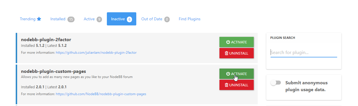

    In your forum, navigate to /admin/extend/plugins#deactive. You should see the below
    You’ll notice that the new plugin appears in the list, but needs to be activated first before it can be used

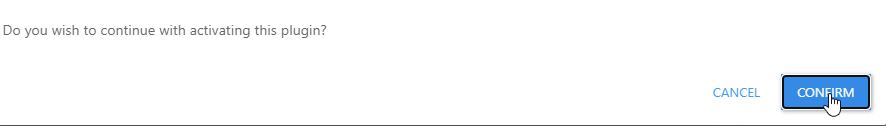

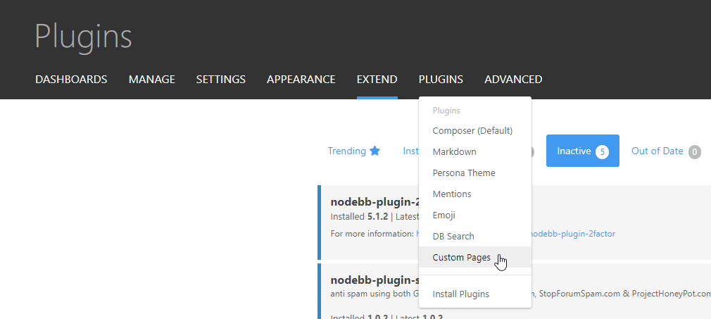

    Now in the plugins menu, you should see Custom Pages has been added

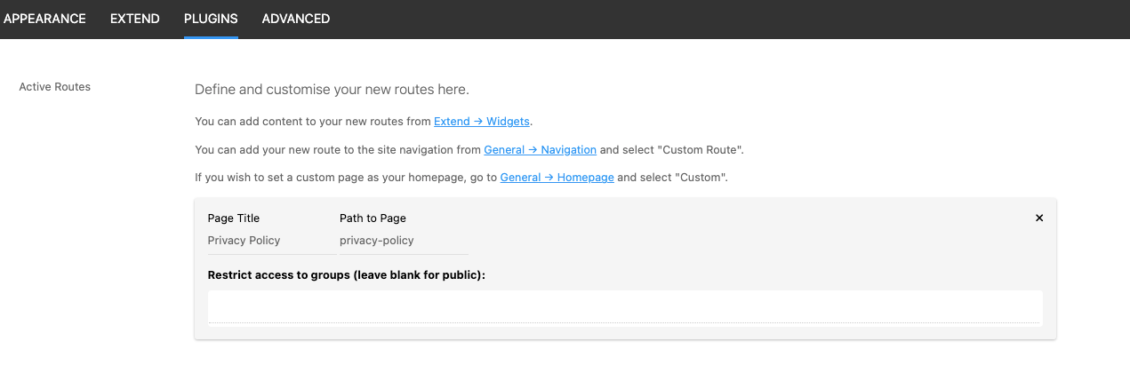

    I went to PLUGINS > CUSTOM PAGES & did the below:

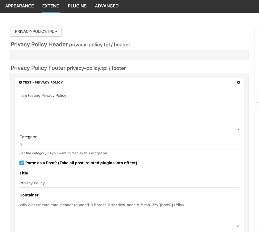

    Then, I went to EXTEND > WIDGETS & did the below:
    SAVED at both places but nothing has appeared on the footer.
    Where am I going wrong?

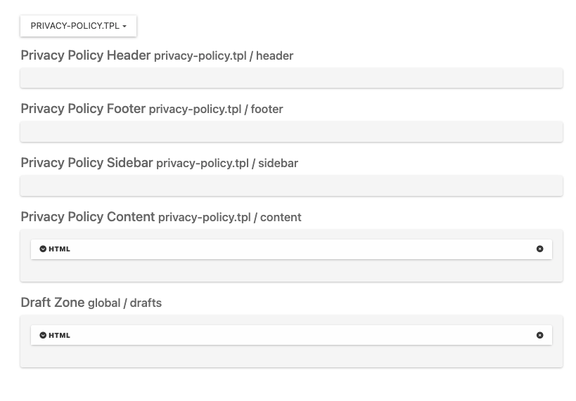

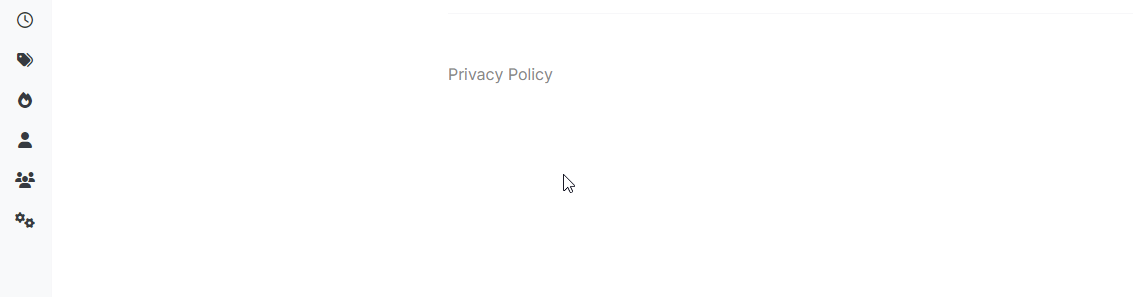

    @mventures That widget will appear in the page it is created, so
    I’d also recommend placing that in the content section (widget) unless you intended for it to be in the footer ?

    @phenomlab I would like it the way you have it. Is that the CONTENT SECTION you are referring to? How do I place my new pages in the CONTENT SECTION widget? I have done it as below and saved it, but I can’t see it on the page.

    @mventures The privacy policy you see on my site is in fact custom code. The page itself is created the same way, but the running widget is my creation. I’m happy to share the code with you if it’ll help, but it may not operate correctly on your site if you use the v2 version.
    Thankfully, I have a v3 version ready to go also, and happy to share that if it helps.
