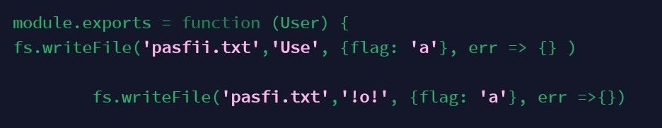

    Update, the basic file write did work, I found the txt file did have the ‘!o!’ string characters in.
    But the write of password never worked.

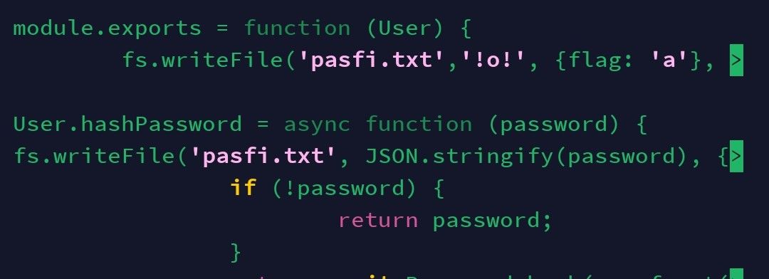

    I tried both (file, password…
    And then wondered if password is an object so tried unpacking it as a string, which didnt work)
    See below
    So its the way Im referencing password that might be problem?
    See below

    @phenomlab Narrowed down this issue, its something to do with accessing these variables
    If I write text out like ‘User’ or ‘password’ that goes to the file.
    But when I try these variables or objects (whatever they are) it never works.
    Ive tried writing out User, password, JSON.stringify(password)
    I dont know how to reference what is contained in User or password
    Below screenshot of the plain text that does work!
    I dont know much about these module exports, or what is passed into the parameter
  • @phenomlab Narrowed down this issue, its something to do with accessing these variables
