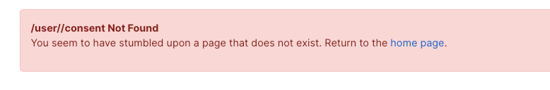

<a href='/me/consent/'>Consent</a>@phenomlab I used that script and I can see it appear on the footer. Is there something else I need to change in the tag because when clicked, I get the below:
Does it have to do with the double slash after “user”: https://mysite/user**//**consent/
I removed the “/” after {username} but that didn’t fix it.
@mventures no, I think you’ll need a
jsfunction to expose the{username}variable from memory. I’ll provide that a bit later today. -
@DownPW @mventures that’s a good point actually. I forgot that route existed.
I’ll update the answer based on that.

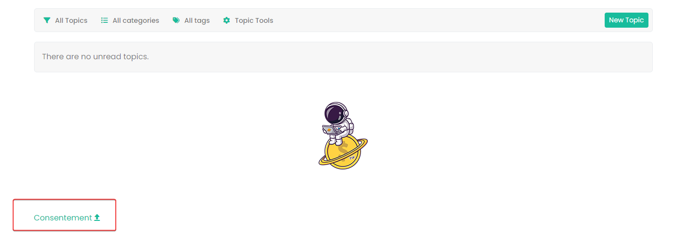

Hello
can you say more about the widget footer mark because i have this on the footer after login
Hello
@DownPW I just logged into your test forum and can’t see that?
yep I have disabled the widget I enabled it
@DownPW Ok. Let me check
@DownPW I still do not see any issues.
