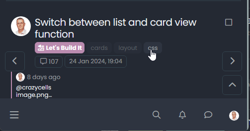

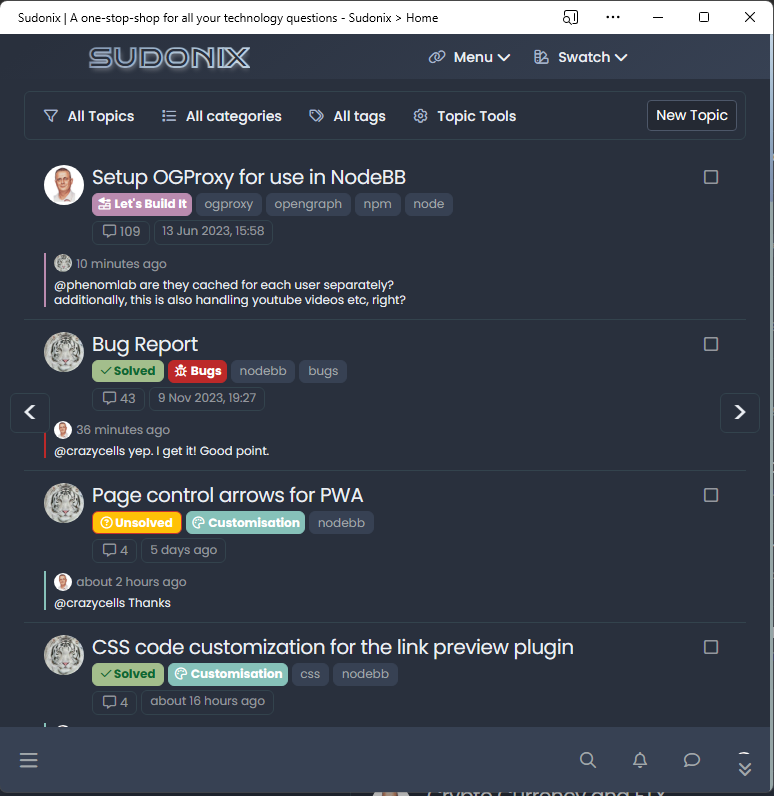

    @crazycells Right - I’ve put together a base design on this site which will only fire when PWA mode is detected. It looks like the below - note the left and right arrows. They are “basic” but functional 🙂
    CSS
    /* START - CSS settings for PWA navigation */
    .arrow {
      width: 40px;
      height: 40px;
      background-color: var(--bs-body-bg);
      text-align: center;
      line-height: 30px;
      cursor: pointer;
      font-size: 30px;
      border: 1px solid var(--bs-border-color);
      border-radius: var(--bs-border-radius);
    .arrow.left, .arrow.right {
        margin-left: 10px;
        margin-right: 10px;
        align-content: center;
        position: fixed;
        top: 50%;
    .arrow.right {
        position: fixed;
        right: 0;
    /* END - CSS settings for PWA navigation */
    JS
    The below code does rely on serviceWorker but that’s typically present in all “modern” browsers
      // Check if serviceWorker API is available
      if ('serviceWorker' in navigator) {
        // The browser supports service workers
        console.log('This web app supports service workers.');
        // Check if the app is installed (as PWA)
        if (window.matchMedia('(display-mode: standalone)').matches) {
          console.log('This web app is running as a Progressive Web App.');
          // Add HTML for navigation arrows
          $('body').append('<div class="navigation"><div class="arrow left">&lt;</div><div class="arrow right">&gt;</div></div>');
          // Handle click on left arrow
          $('.arrow.left').click(function() {
            history.back(); // Go back in history
          // Handle click on right arrow
          $('.arrow.right').click(function() {
            history.forward(); // Go forward in history
        } else {
          console.log('This web app is not running as a Progressive Web App.');
      } else {
        console.log('This web browser does not support service workers.');
    Again, this is basic and more of a POC. Other functionality can be added in a similar way if you’d like it.

    @phenomlab thank you very much 🙏
  • @phenomlab thank you very much 🙏
    @crazycells what would be the z-index value to hide it when the navigation menu options appear? I believe they should be invisible when those options panels are opened…
  • @crazycells what would be the z-index value to hide it when the navigation menu options appear? I believe they should be invisible when those options panels are opened…
    @crazycells yeah, I set that quite high at 9999 which is complete overkill! Try lowering that value to something more sane like 1500

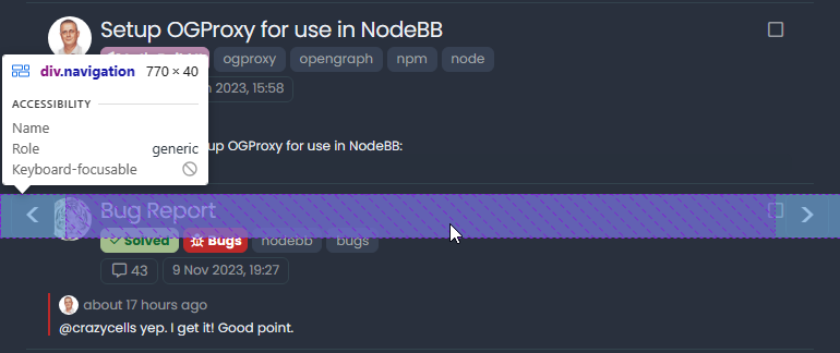

  • @crazycells I think I found a bug. If you position a topic between the two navigation arrows on a mobile device, you cannot click that topic until you scroll up or down past the arrows. I noticed this last night and will address it.
  • A better explanation of that is below
    As you can see from the developer view, the width: 100%; sits over the top of the topic meaning it cannot be clicked or tapped. A workaround here should be to set z-index: -1; on the navigation class, but whilst that resolves the ordering issue, it means the navigation buttons no longer work as they sit under the content.
  • Fixed. Change the CSS block (original post is also updated) to the below

  • I have not tested them in details yet, but I will let you know about any bugs for sure 👍🏼
    Additionally, is there any reason that they are in the middle but not close to the bottom? That is usually where the fingers will be
    @crazycells They can be anywhere you’d prefer. You can just change the .arrow.left, .arrow.right class to move to the preferred position. Currently, it’s set at 50%, but can be any value you want to reach the desired position. In this case, it would probably be better to substitute top for bottom and set the position in px to ensure the placement is the same no matter which screen estate you have.

    @phenomlab thanks, yes, I will move them close to the menu bar, but I was asking in case there is a technical detail I was not aware…
  • @phenomlab thanks, yes, I will move them close to the menu bar, but I was asking in case there is a technical detail I was not aware…
    @crazycells No, none that I am aware of - move them to where you’d prefer. In fact, I took your advice and moved them on Sudonix, which uses the CSS class I added in the previous post.
  • @crazycells No, none that I am aware of - move them to where you’d prefer. In fact, I took your advice and moved them on Sudonix, which uses the CSS class I added in the previous post.
    @phenomlab yes, I believe this looks more natural, they are closer to the fingers and on the top of these, it is not blocking any content in the middle of the screen…
  • @phenomlab yes, I believe this looks more natural, they are closer to the fingers and on the top of these, it is not blocking any content in the middle of the screen…
    @crazycells Exactly. i’m going to hire you as a design guru! You have some great ideas on what Sudonix should look like and I’m grateful for any contribution that enhances what I hope is already a good experience.
  • @crazycells Exactly. i’m going to hire you as a design guru! You have some great ideas on what Sudonix should look like and I’m grateful for any contribution that enhances what I hope is already a good experience.
    @phenomlab It is nice to hear that I am able to contribute your website 😄
