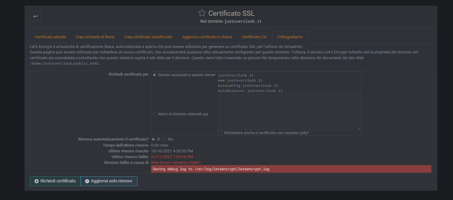

    @justoverclock Hi, and happy new year !
    If you go to Virtualmin->Server Configuration->SSL Certificate->Let’s Encrypt, what values do you see in the below ?
  • @justoverclock Hi, and happy new year !
    @phenomlab happy new year to you also!
  • @phenomlab happy new year to you also!

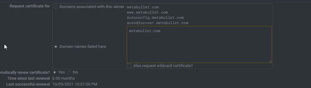

    @justoverclock Ok, that’s because you have no wildcard DNS record, and it’s attempting to renew for domains you don’t have listed in DNS.
    Select the second option, and enter justoverclock.it and proceed that way.
    Note, that there is a rate-limit set to 10 per hour, so if you exceed this, you’ll need to wait for a while then try again. In this case, you’d see this message

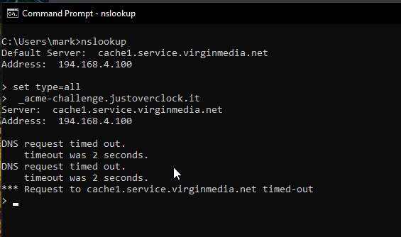

    @justoverclock Seems your _acme-challenge DNS record is missing ?
  • @justoverclock Seems your _acme-challenge DNS record is missing ?

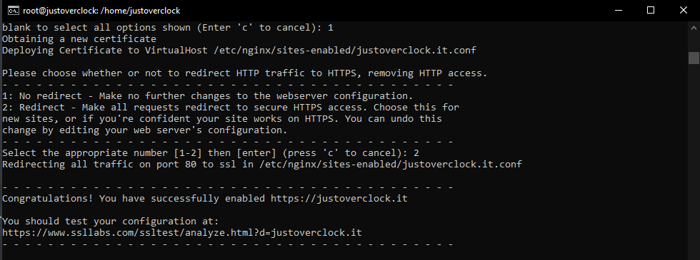

  • @justoverclock I have installed the --nginx version of certbot on your server as per
    https://sudonix.com/post/689
    It’s showing that the renewal will work, but the rate-limit is currently still enforced, so we still need to wait.
    Performing the following challenges:
    http-01 challenge for justoverclock.it
    http-01 challenge for www.justoverclock.it
    Waiting for verification...
    Cleaning up challenges
    new certificate deployed with reload of nginx server; fullchain is
    /etc/letsencrypt/live/justoverclock.it/fullchain.pem
    ** DRY RUN: simulating 'certbot renew' close to cert expiry
    **          (The test certificates below have not been saved.)
    Congratulations, all renewals succeeded. The following certs have been renewed:
      /etc/letsencrypt/live/admin.justoverclock.it/fullchain.pem (success)
      /etc/letsencrypt/live/forum.justoverclock.it/fullchain.pem (success)
      /etc/letsencrypt/live/justoverclock.it/fullchain.pem (success)
    **          (The test certificates above have not been saved.)
    IMPORTANT NOTES:
     - Your account credentials have been saved in your Certbot
       configuration directory at /etc/letsencrypt. You should make a
       secure backup of this folder now. This configuration directory will
       also contain certificates and private keys obtained by Certbot so
       making regular backups of this folder is ideal.
    root@justoverclock:/home/justoverclock#
  • @justoverclock should be resolved now
    As a side note, this renewal won’t show in Virtualmin unless it is requested from there. This is done from the command line, so
    1. SSH into the server
    2. Change to root
    3. Execute certbot --nginx and follow the prompts
