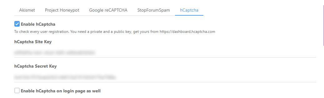

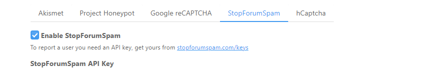

    @mventures It won’t save because you first have to enable the “Stop Forum Spam” tab and subscribe for a (free) key
    I’ve enabled this, and provided you with my key temporarily, which you should change
    I then enabled hCaptcha using my details, and registered your site with my hCaptcha account
    This now works as intended
    You should of course register your own site and secret keys rather than use mine 🙂

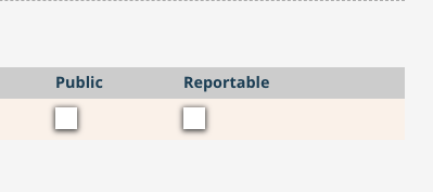

    Should I tick one of these? I know it’s optional but if there is a benefit in someway, I can tick.
    Update: I have replaced your values with mine. It seems to be working now.
    @mventures none that I know of. I don’t recall selecting these either for mine.
