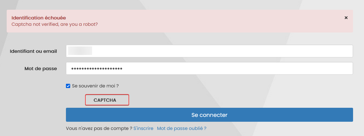

    I have a Captcha bug after upgrade on login connexion.
    Without that, impossible to connect to nodebb due to captcha bug
  • I have a Captcha bug after upgrade on login connexion.
    @DownPW that’s not a bug as it works fine on my Dev install.
    Anything in the console?
  • @DownPW that’s not a bug as it works fine on my Dev install.
    @phenomlab I have rebuild and it’s OK now.
    odd but it’s a beta i guess 😉

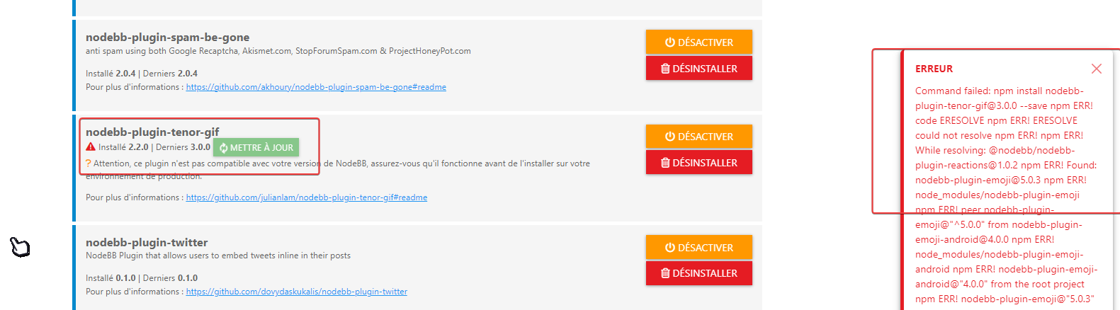

    and you upgrade via cli your plugin ?
    I have this with acp on all plugins to update :

    Exemple here for update this plugin must to test :
    npm install nodebb-plugin-tenor-gif@3.0.0

    Ok like pitaj said on nodebb communauty i have test this :
    npm config set legacy-peer-deps true
    and the plugins is installed without error on ACP
    Maybe add this on your first topic 😉
    @DownPW good call. Will get that added.
