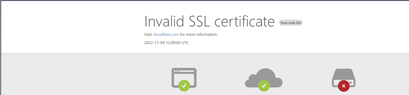

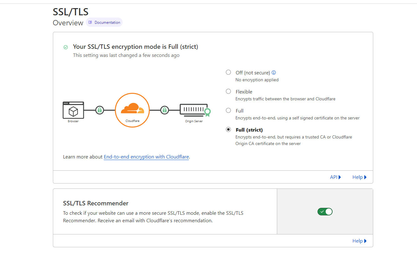

    @cagatay No, I don’t think so. I think this is related to SSL enryption. In Cloudflare, can you set the SSL encryption for this domain to full ?
  • @cagatay No, I don’t think so. I think this is related to SSL enryption. In Cloudflare, can you set the SSL encryption for this domain to full ?
    @phenomlab now yes; was flexable 😞
  • @phenomlab now yes; was flexable 😞
    @cagatay Thought so.
    Now we have to deal with the invalid cert
  • @cagatay Thought so.
    @phenomlab sorry for small detail 😞
  • @phenomlab sorry for small detail 😞
    @cagatay No problem - can you set it to full and not Full (Strict)
  • @cagatay No problem - can you set it to full and not Full (Strict)
    @phenomlab setted
    @cagatay Working now 🙂
