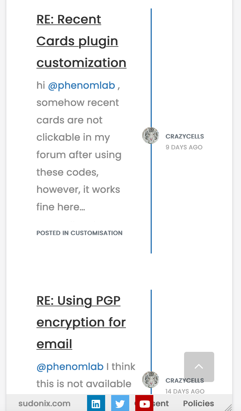

Unrelated: I like this at the bottom of the post:
Referenced by
phenomlab phenomlabWhich plugin is that?
@phenomlab wow, no surprise you had thought of this. Yeah I want to keep versions but of course I can do that while still pushing things to an RSS feed.
Will ask @JAC , thanks for the idea and potentially the scripts!
Referenced by
@qwinter said in Using nodebb as a publishing destination, posting after git push?:
It’s part of core
