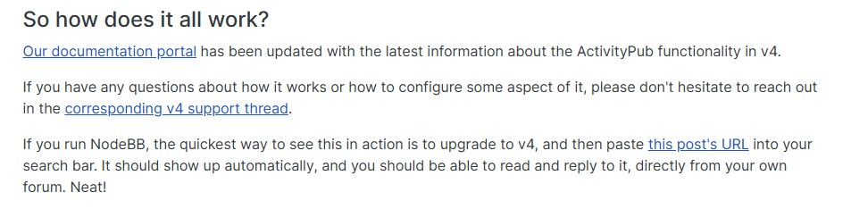

@cagatay see
https://community.nodebb.org/topic/18545/nodebb-v4.0.0-federate-good-times-come-on?_=1737549145517
Specifically, this section

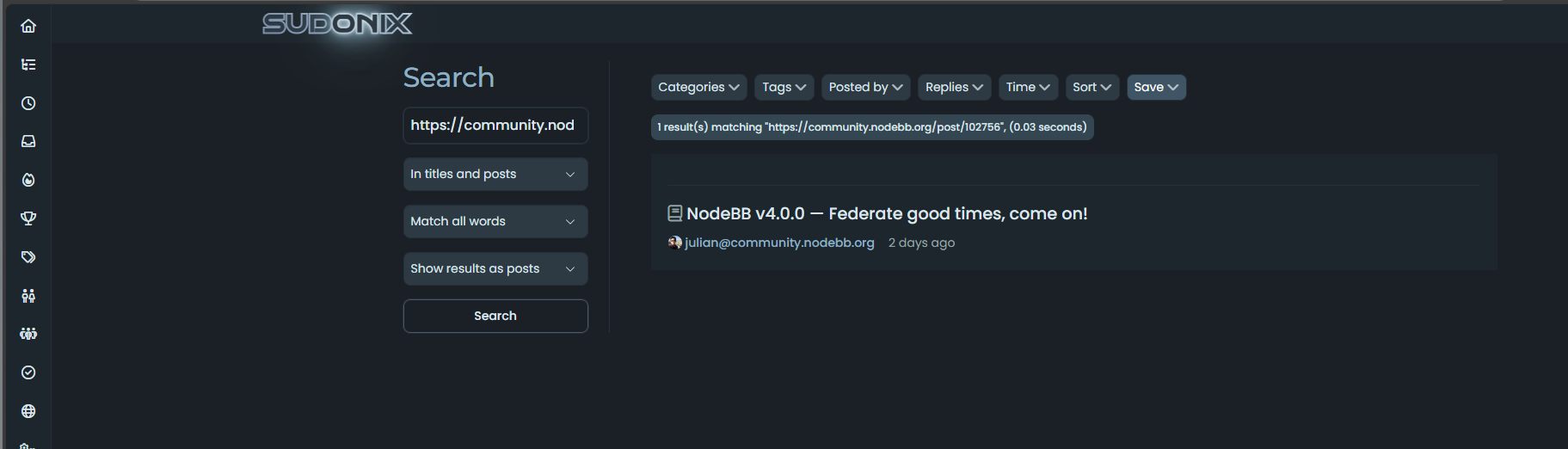

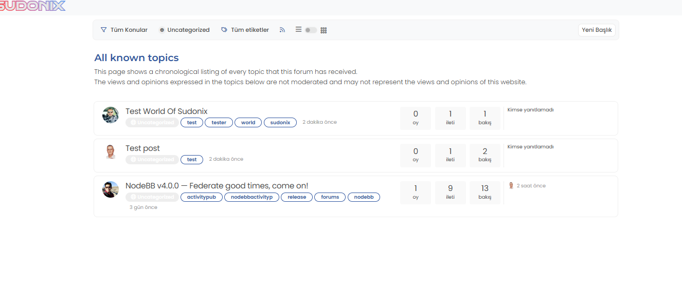

I created a topic, but when I search for the link, it doesnāt appear either on your site or on NodeBBās own site.
@cagatay It does - look at the second post in your screenshot

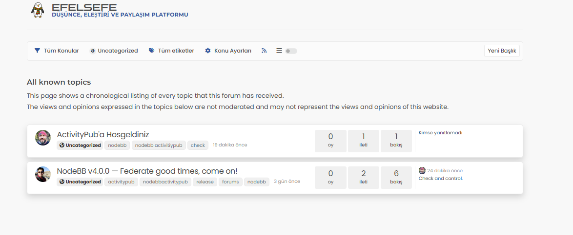

@phenomlab yes i see that but mine is not working, i m not see my post in your web site when i searched my linkā¦

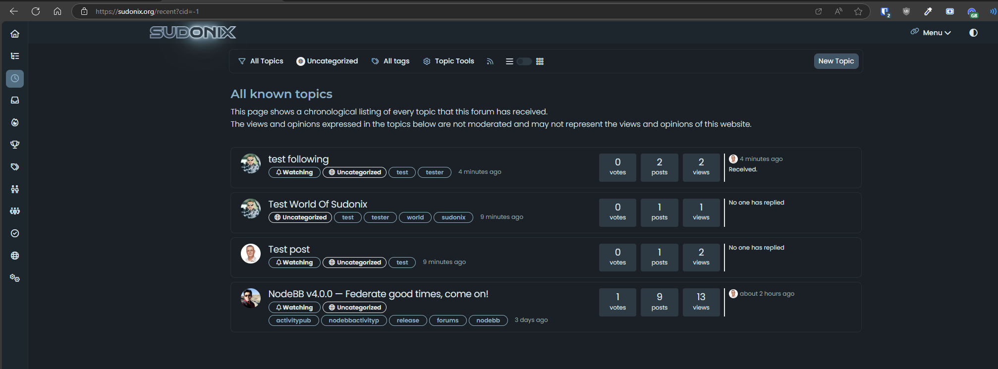

@cagatay For federation to work between two NodeBB sites, you have to follow users in the remote site.
If I follow you here and you share something in World, will I see it on my own site? Shall we test this?
@cagatay Good idea. Letās try it.
@phenomlab i m following you and opened topic, tested link on my web site. result 0
did not see anything. -
could you please follow me also?
@cagatay Yep. Done

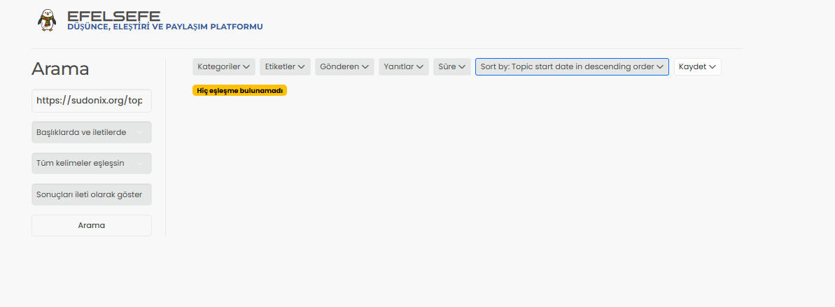

link is not working

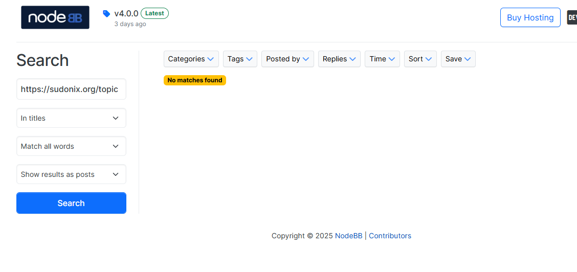

@cagatay Search the same link on your own forum
same
Yes, I can see these while on your site, and I created the topic from your site in the World category. However, I should also be able to see the links on my own site or the NodeBB site, but I canāt, even though I am following you.
@cagatay Yes, exactly that.
