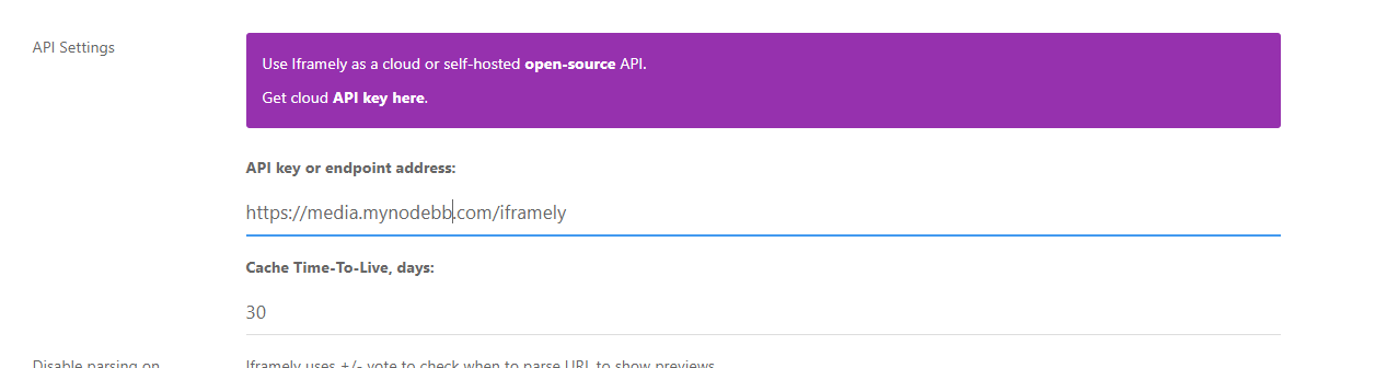

    3. Now navigate to admin/plugins/iframely in your NodeBB installation
    4. Enter the URL you are going to be using as below
    Make sure that the URL is appended with /iframely as this is the API endpoint where requests are sent
    1. Save the settings
    2. Reload NodeBB

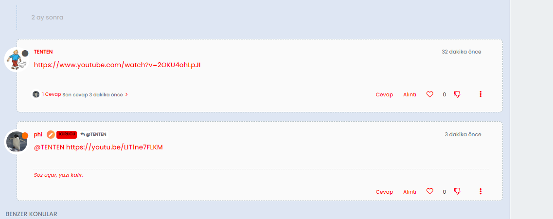

    1. Create a new post and place a URL inside it such as https://www.whatsmydns.net/ inside it
    2. Add tags if needed
    3. Post it
    Hopefully, it’ll look something like this

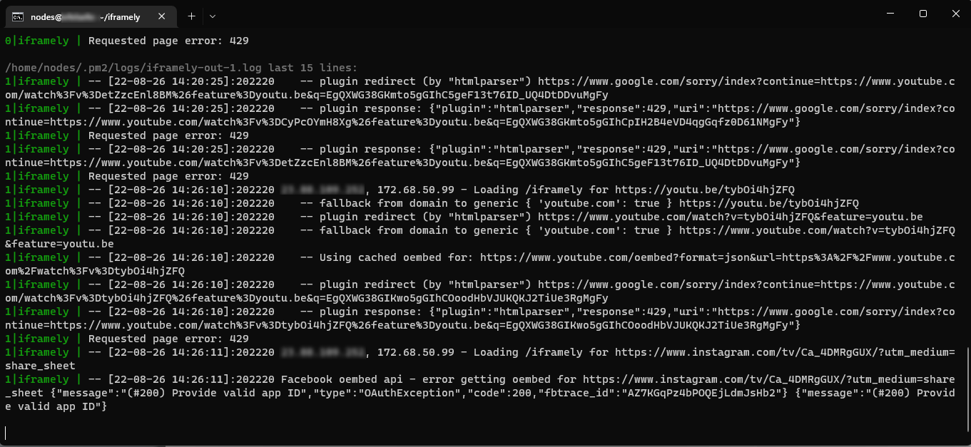

    In addition, if you switch back to the server CLI, you should see items being logged. At this point, it works 🙂 but you’re not quite finished

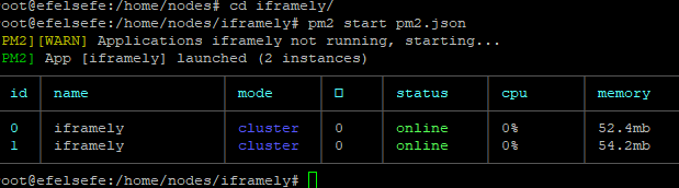

    npm install pm2 -g
    pm2 start pm2.json
    pm2 logs
    Again, make sure that the account you are using has root permissions when try to use npm install as previously mentioned
    You should hopefully see a log being generated like the below which is updated in real time when accessing posts with links
    You can safely exit the log with CTRL + C which won’t affect the daemon.
    If you want to see if the process is running or not, you can use pm2 status
    Similarly, if you need to restart the instance, you can do so using
    pm2 reload iframely

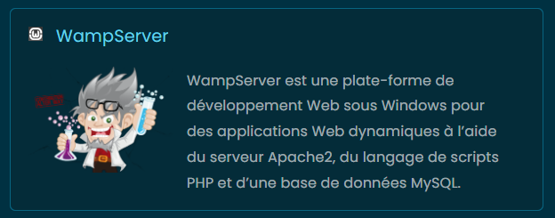

    @crazycells I tried this CSS, and it looks a little “cramped” to me - why not post some screenshots ?
    here is an example… Since previews are just previews and do not give the whole info, we prefer to see them in the text as a small banner with some info in it… free iframely takes a much larger unnecessary space from the post…
  • here is an example… Since previews are just previews and do not give the whole info, we prefer to see them in the text as a small banner with some info in it… free iframely takes a much larger unnecessary space from the post…
    @crazycells looks like you’re using a 100% width there which would explain the cramped look on here as I set a static max-width 👍
  • @crazycells looks like you’re using a 100% width there which would explain the cramped look on here as I set a static max-width 👍
    @phenomlab yes, you have very customized themes here; so I guess CSS codes will need some adjustments for a similar look…

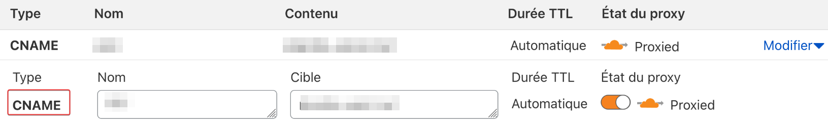

    @DownPW you will win this war 🙂
    A CNAME on Cloudflare is not sufficient ?
    like this :
    like this :
    @DownPW no. It needs to be an A record. CNAME is canonical meaning that traffic sent to it will land up at your main nginx site. The A record will sent headers which nginx can use to route the traffic correctly.
    CNAME records do not have this and will resolve to the underlying host which will cause you problems. Useful for WWW and non-WWW, but that’s about it.
    Essentially, it’s an alias and not a record in it’s own right.
  • @DownPW no. It needs to be an A record. CNAME is canonical meaning that traffic sent to it will land up at your main nginx site. The A record will sent headers which nginx can use to route the traffic correctly.
