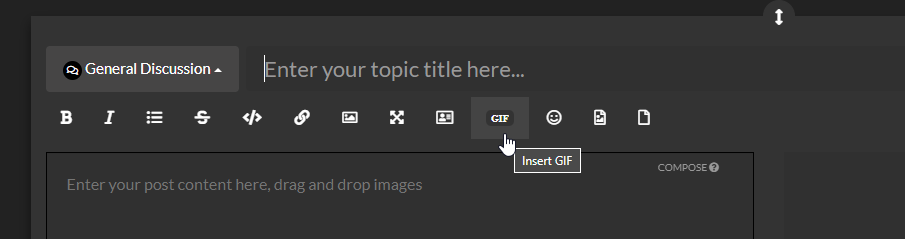

  • @Sampo2910 I’ve also just fixed the tenor-gif missing icon issue. This is in fact not an actual font-awesome icon, but some CSS, which I’ve added to your forum
    .fa-tenor-gif::before {
        content: 'GIF';
        font-size: 1rem;
        font-family: sans;
        background: #333;
        color: #fff;
        padding: .25rem .5rem;
        border-radius: .5em;
        position: relative;
        top: -.2rem;
    Should show correctly now

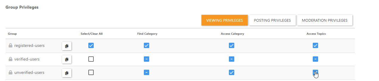

    @Sampo2910 Yes, perfectly possible. You just need to change each category where that will be in effect so that unauthenticated users need to login first before they can view.
    For example, go to /admin/manage/privileges/1 (in this case, “1” is the ID of the first category)
    Click
    In permissions, remove the tick from here
    This allows the user to enter the category, but not the topic itself without being logged in
    Save the change
    Test it with guest access. You should be able to open the category with no issues, but as soon as you try to read the topics, you’ll be asked to login

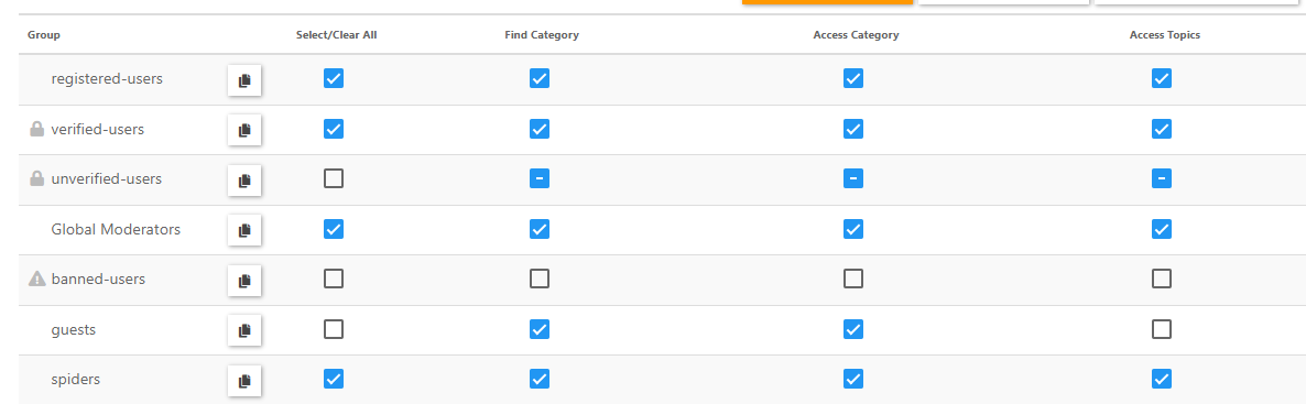

    @phenomlab This is same if i click on recents or ‘home’
    These are the settings. I have copied to all becuase they would all be the same anyway. (for now at least during forum setup)

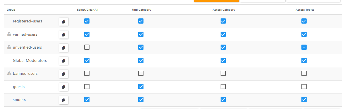

    @Sampo2910 Can you try again but this time allow “Access Category” ? I just tested this on my dev site, and it works as expected.
  • @Sampo2910 Can you try again but this time allow “Access Category” ? I just tested this on my dev site, and it works as expected.
    It is already ticked and allowed in the image. Should this not be for guests rather than unverified users?

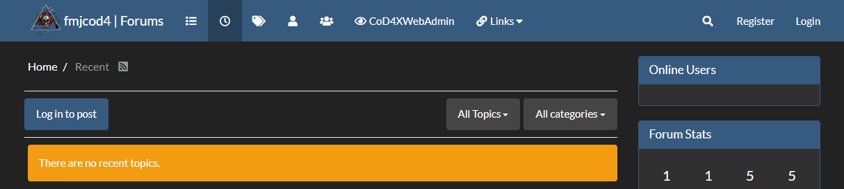

    Well I still cannot get it to work with guests 🙂 Every category is like this now.
    If i logout and try to click on groups or users I am taken to the login page. Clicking on home or recent is as below.
