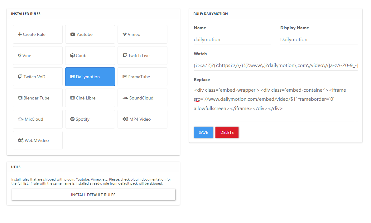

    @DownPW Did you get the Daily Motion Embed to work ?
  • @DownPW Did you get the Daily Motion Embed to work ?
    @phenomlab nope!
    @DownPW Hmm - it’ll work with iFramely (locally hosted), or you can use the below string to embed using https://community.nodebb.org/topic/7135/nodebb-plugin-ns-embed-ns-embed/114
    Watch
    (?:<a.*?)?(?:https?:\/\/)?(?:www\.)?dailymotion\.com\/video\/([a-zA-Z0-9_-]{4,11})(?:.*?\/a>)?
    Replace
    <div class='embed-wrapper'><div class='embed-container'><iframe  src='//www.dailymotion.com/embed/video/$1' frameborder='0' allowfullscreen></iframe></div></div>
