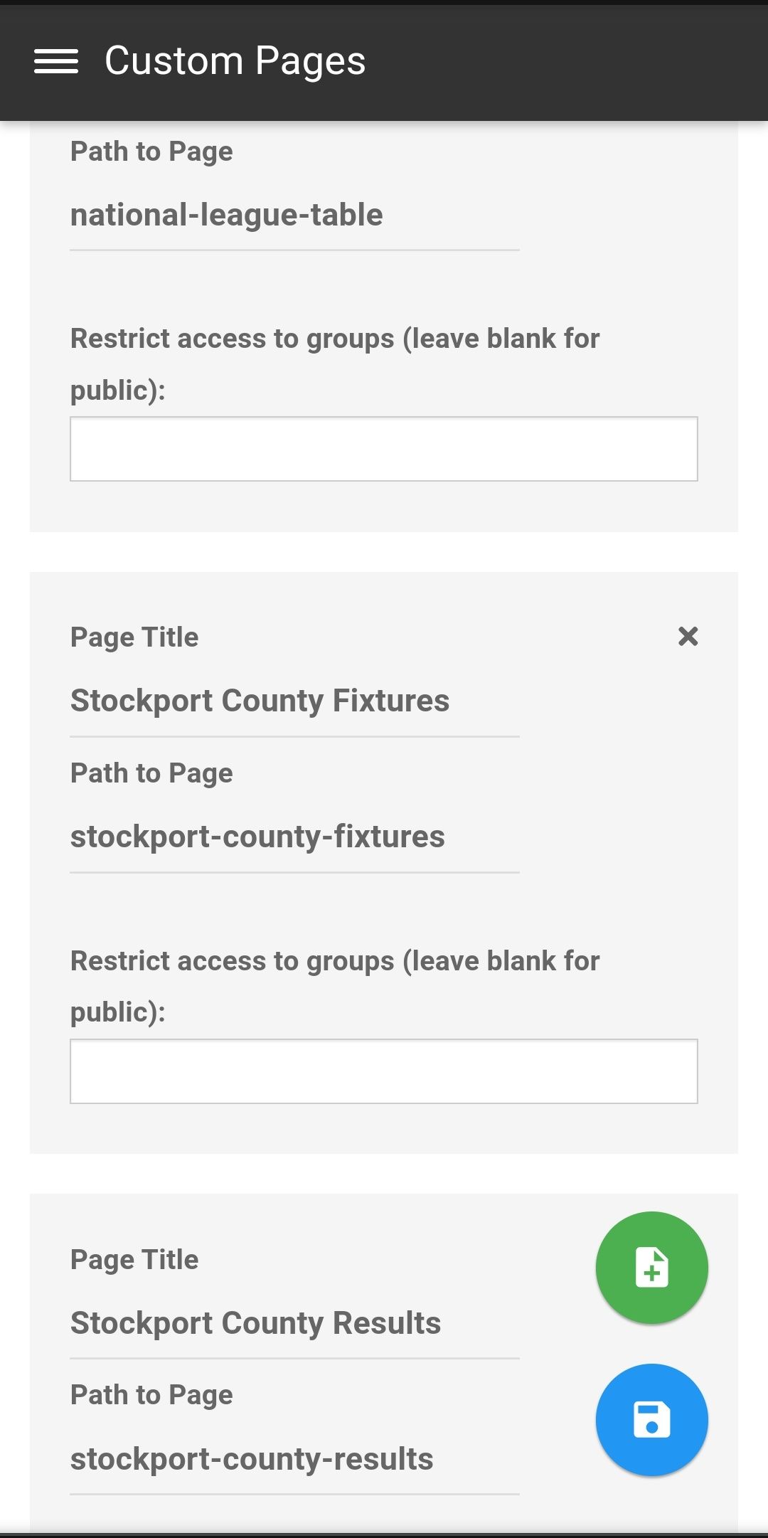

    Hi Mark,
    I have created a few pages, one works fine, the other two say “Not found”.
    I have looked and can’t see any issue?
    Hi Mark,

    @jac I’ve deleted them and re -created them.
    Once in widgets it seems like the old widgets (created pages) are still there with a capital letter which was the first one I created.
    It needs to work without a capital letter, but it won’t show as a page without it? I wonder if you can take a look?
    Many thanks

    @jac I’ve had a look at this, and he reason as to why this fails is because the slug specified starts with a capital letter. Under Windows, there is no distinction, but under Linux (which is what your VPS is running), this matters in the sense that you can use the same wording but different cases allows you to treat them as separate pages.
    To work around this, the “Path To Page” value should always be in lower case. I’ve changed these so they should work now

    Absolutely, I’d changed them to lower case and they still returned a page not found message. However when I entered a capital letter at the start the page then was showing fine.

    Looks like it is working now mate, thanks very much. I will find and re-add the fixtures code.

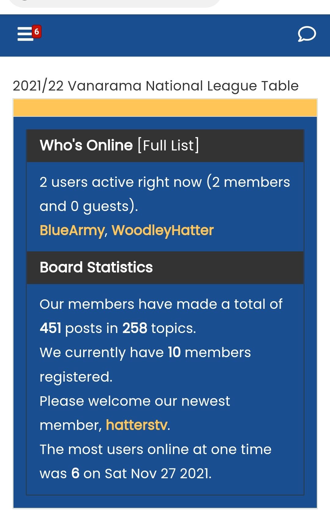

    I think when the links from the Nav bar drop-down are clicked the page loads but the football content (table) for example doesn’t load.
    Could this be because it’s asked to open in a new tab? Although this doesn’t load either.

    @jac however on more digging I’ve found that if you go directly to the link then the table shows up no issues.
    @jac Yes, this is likely to be an issue with how the script is being called. I’m guessing the page loads when accessed directly, but not via the forum itself ?
    EDIT - suspicion confirmed. The page loads without issue if accessed directly.

    @jac this should work now. It’s a little primitive, and means the page has to load twice, but it’ll work as desired. Essentially, the below code when added to each widget will force the page to reload directly
    <script>
    $(window).on('action:ajaxify.end', function (data) {
        location.reload();
    </script>

    Brilliant, thank you very much Mark!
