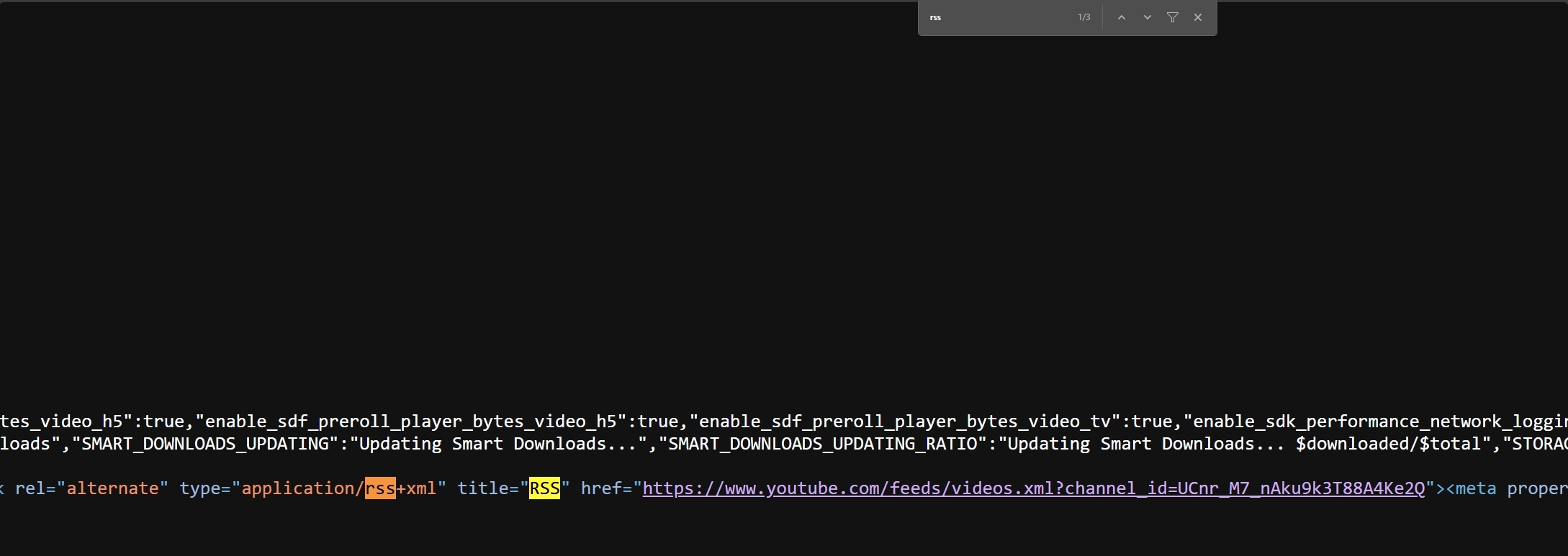

    4. In this new tab, press F3 on your keyboard which should open the “find” utility
    5. In the search window, type RSS and press enter
    6. You should be able to find something the like the below
    7. Copy the RSS URL - in this case, it’s the below, but only the actual URL highlighted
    8. Now we just need to convert the link above, and append the channel ID after the = sign
    9. The link you land up with becomes https://rsshub.app/youtube/channel/UCnr_M7_nAku9k3T88A4Ke2Q
