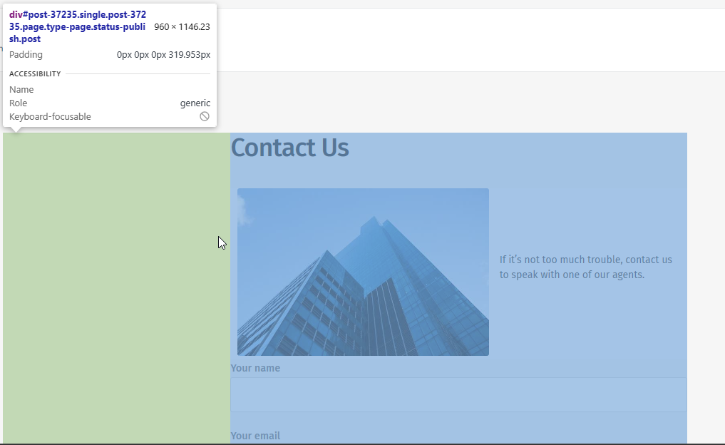

    @Sala It appears to be caused by the below
    As you can see, there is a large section of empty space to the left, although if you look at the other pages, this area is used (as you indicate) for dates etc. It’s likely that this specific page uses a template which can be changed by accessing the page itself in WordPress and changing the template in use.
    I wouldn’t recommend changing anything with CSS without looking at the theme’s structure first as this is likely to have a knock-on effect for the remainder of the site.

    @Sala Before we do anything else, we need to understand how the Post ID is being generated - see below from the contact page
    If these are being generated dynamically, they will be difficult to target. However, if they correlate to actual ID’s being stored in the database, then this will be simpler. I will need access to your site as an admin to be able to determine this.
