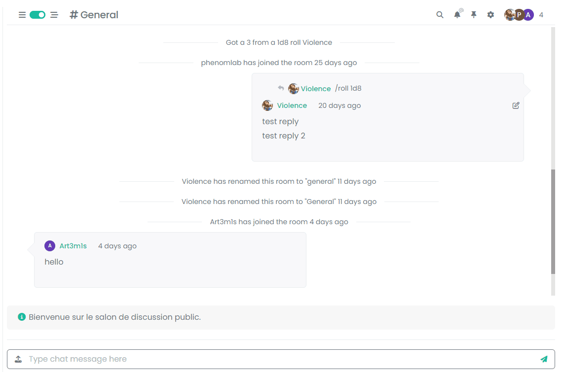

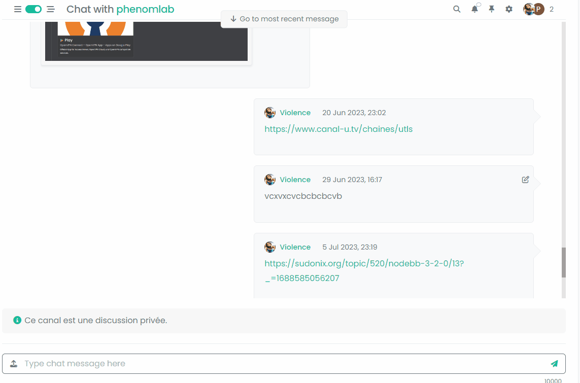

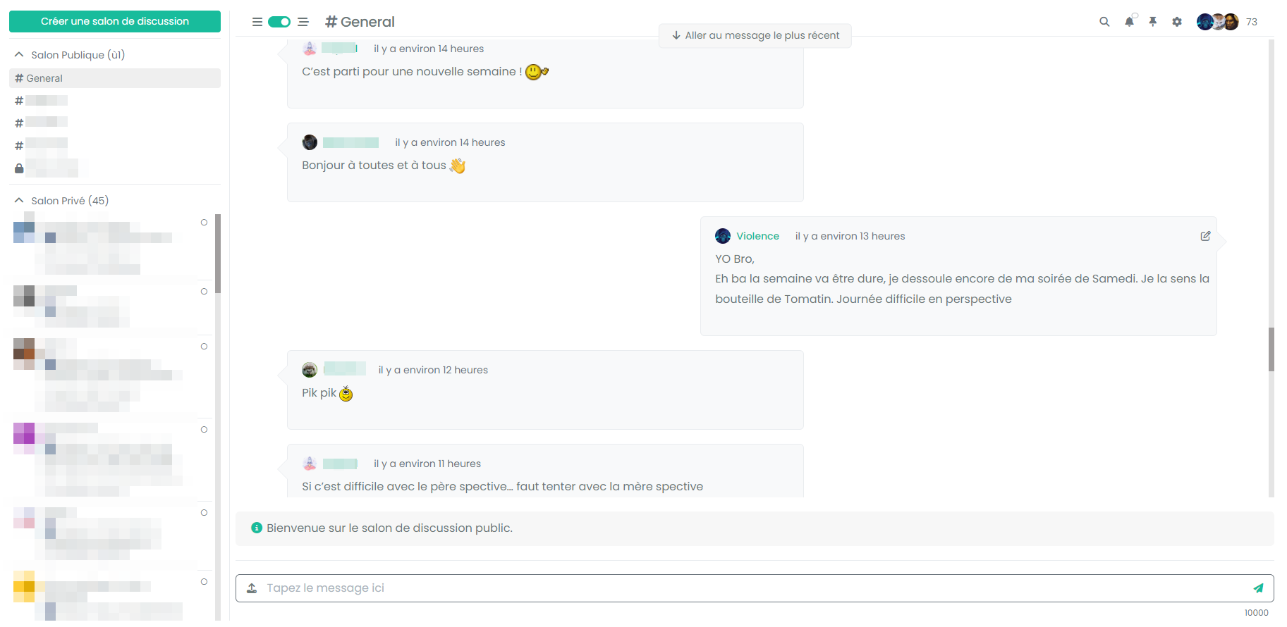

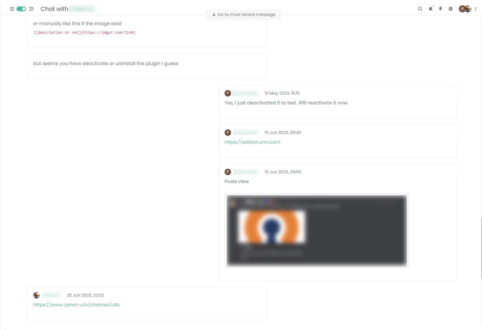

    hello my friend @phenomlab continue t otest and debug, I see this bug.
    When you edit your post and save it, you lose the display (or the post simply disappears) and you have to refresh the page to see it again and display it correctly
    EDIT:
    • in public can :edit post lose display/layout
    • In private chat : edit post lose the post
    public :
    private:
  • hello my friend @phenomlab continue t otest and debug, I see this bug.
    EDIT:
    public :
    private:

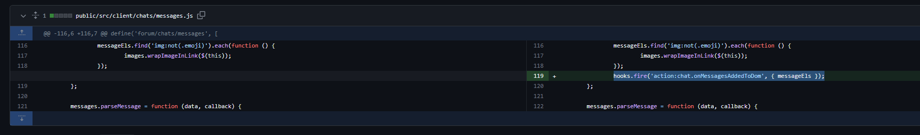

    this :
    $(window).on('action:chat.onMessagesAddedToDom', function(data) {
        	    console.log('hook triggered');
            threadedChat();
    Seems you have add it on the function.js on github no ?
  • this :
            threadedChat();

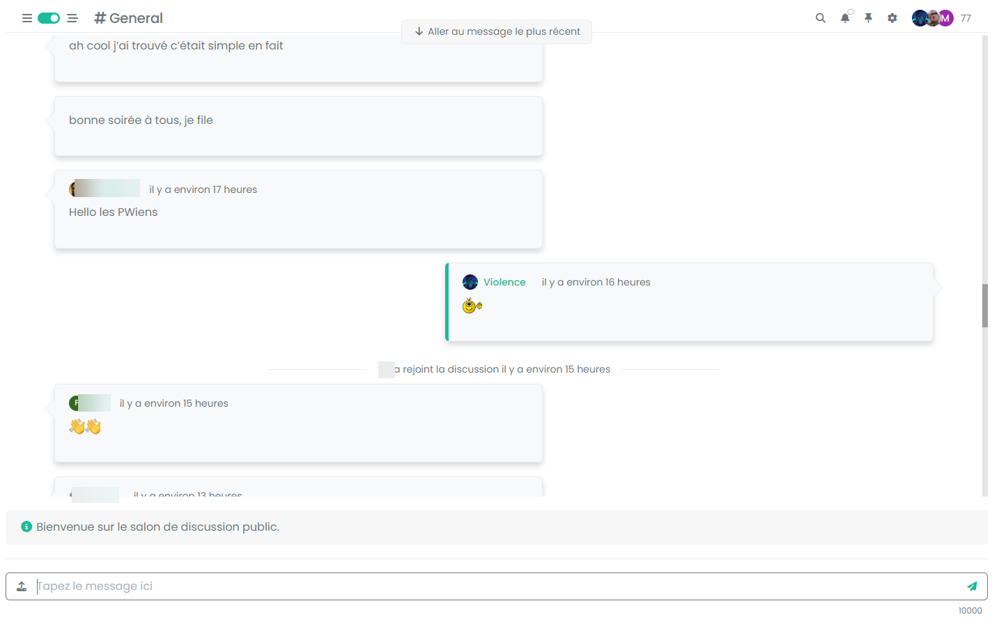

    #30
    @DownPW Yes, but check the git link - you need to modify public/src/client/chats/messages.js as below
    https://github.com/NodeBB/NodeBB/commit/a7517d886f83703dc158c0e2327542156b539eb6
    #31
    ha ok I misunderstood that. I thought it was just to add in the Javascript code.
    So we have to create the hook manually until 3.5.0
    Do you think this will solve the problem?
    Test ASAP
  • ha ok I misunderstood that. I thought it was just to add in the Javascript code.
    Test ASAP
    #32
    @DownPW said in Threaded chat support for NodeBB:
    Yep - I have the patch and cannot replicate the issue on here 🙂

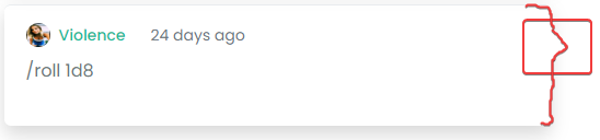

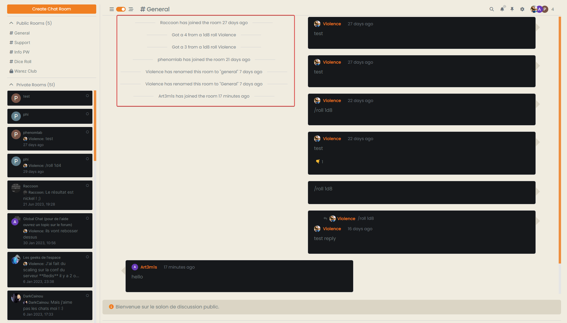

    #34
    Better like this : add shadow and border-left on self answer 🙂
  • Better like this : add shadow and border-left on self answer 🙂
    #35
    Of course - you style to your own requirements and taste 🙂 I’ll commit that CSS we discussed yesterday also
