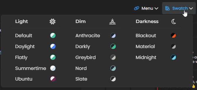

    1. The Brand Header widget - this is used for the actual HTML that contains all of our selections (Light, Dim, Darkness)

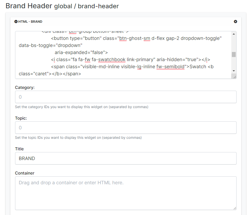

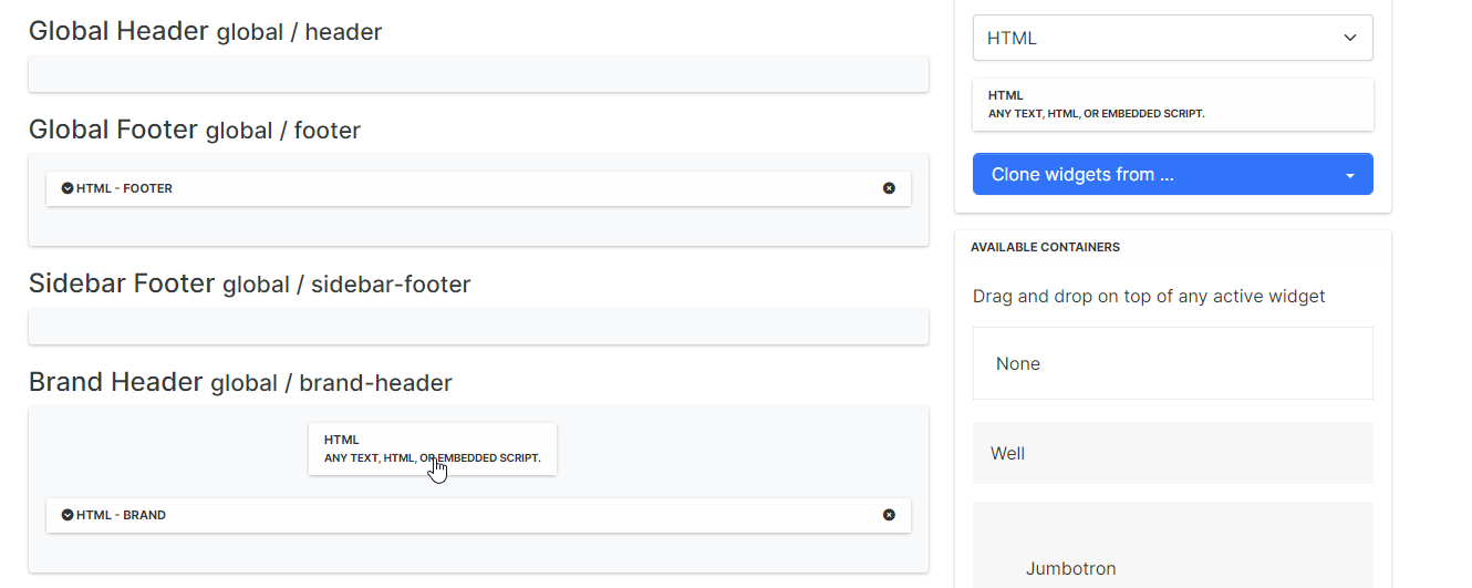

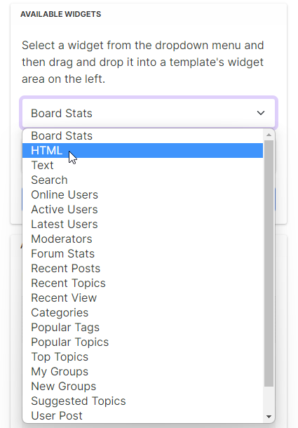

    In your ACP, go to /admin/extend/widgets and look for
    Brand Header global / brand-header
    Using the selectors on the right, drag the HTML widget into this area
    Drop it into the area shown in the screenshot. This will form the container for the HTML code we need to add, which is here
    https://github.com/phenomlab/swatch/blob/main/widget.html
    Copy all of the code from the link above into the widget you just created
    Don’t forget to save

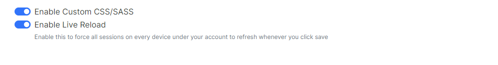

    Now go to /admin/appearance/customise#custom-css and paste the CSS into the resulting window at the end of the existing CSS you created above. Again, make sure these are set to on
