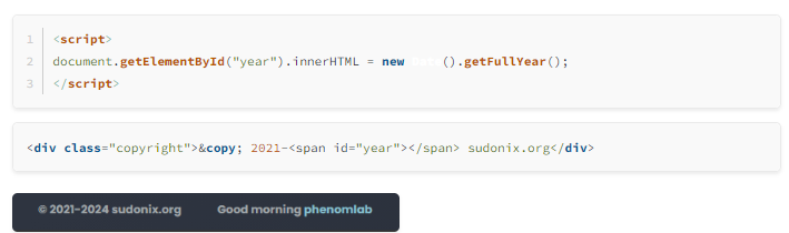

    @cagatay That’s in the footer widget on your site. You need to add the js at the bottom of the page including the <script> and </script> tags plus all text in between those, then modify the line I referenced with the updated code.

    @cagatay Should work now. The code
    <script>
    document.getElementById("year").innerHTML = new Date().getFullYear();
    </script>
    Needs to be placed at the bottom of the footer widget code 🙂

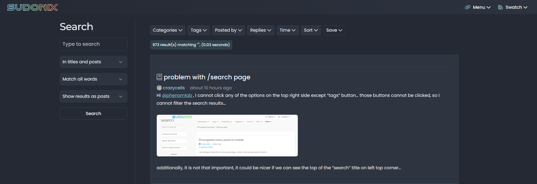

  • @crazycells This should be fixed now
    It’s caused by the addition of breadcrumbs into the Harmony theme which alters the page layout. Sudonix uses a heavily customised theme 🙂
    @crazycells said in problem with /search page:
    additionally, it is still not that important, but I believe the info “ 2021-2023 sudonix.org” at the bottom of the page should be 2024… at some point we should stop living in the past and seize the future lol
    Good catch. This has been fixed also using js to calculate the current year so it will roll forward itself in future.
    <script>
    </script>
    <div class="copyright">&copy; 2021-<span id="year"></span> sudonix.org</div>
