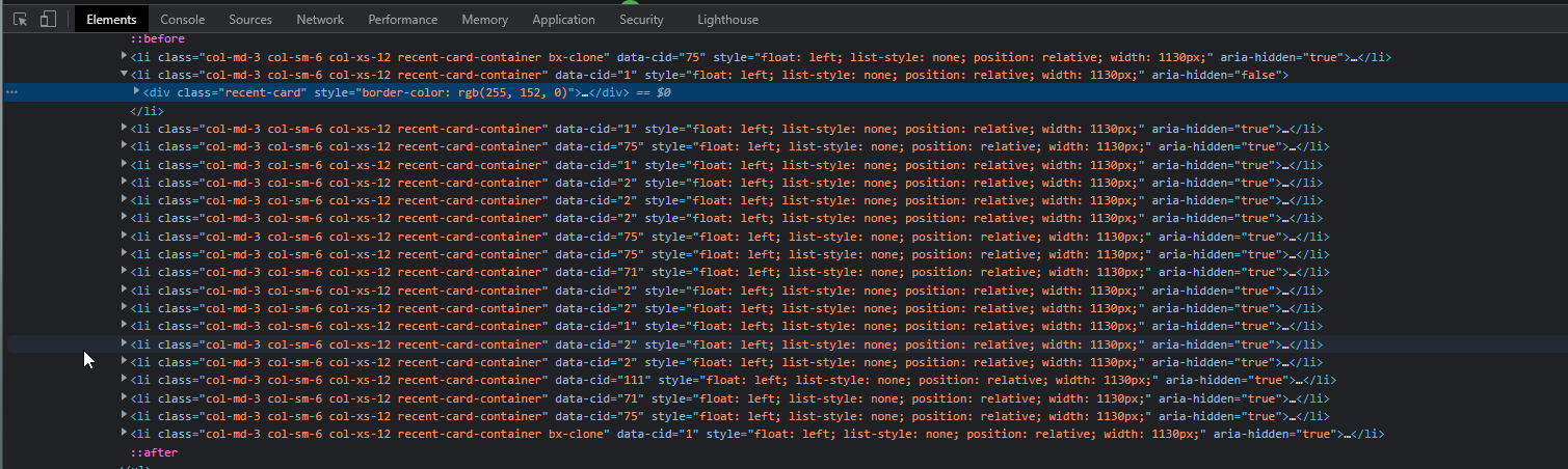

  • @crazycells If you can’t find it, this will resolve it
    li.col-md-3.col-sm-6.col-xs-12.recent-card-container {
        width: 290px !important;
    @phenomlab said in Recent Cards - fix for slider on mobile not working:
    I could not find any CSS codes related to the width of these cards, but this code solved the problem. Thanks.

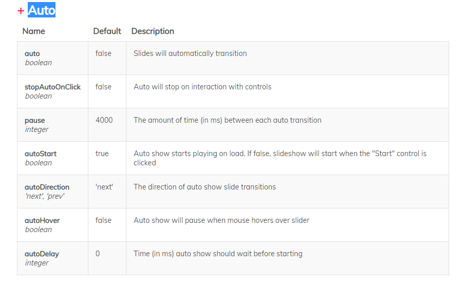

    @phenomlab to stop automatic movement, I should do:
    auto: false,
    right?
  • @phenomlab to stop automatic movement, I should do:
    auto: false,
    right?
    @crazycells Yes, or just remove it
  • @crazycells Yes, or just remove it
    @phenomlab yeap, I see it now. Thank you very much. 🙏
