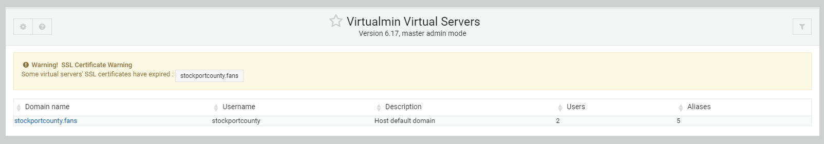

    @jac it’s up, but it looks like the certificate has expired.
  • @jac it’s up, but it looks like the certificate has expired.
    @phenomlab Oh right still not loading for me. How do I fix this?
    Many thanks.
    Many thanks.
    @jac As I thought
    Checking now
    Seems there’s an issue with Let’s Encrypt on this server. For reasons unknown the cert will not renew, and you get a maximum of 10 retries per day per domain, which have now been exhausted.

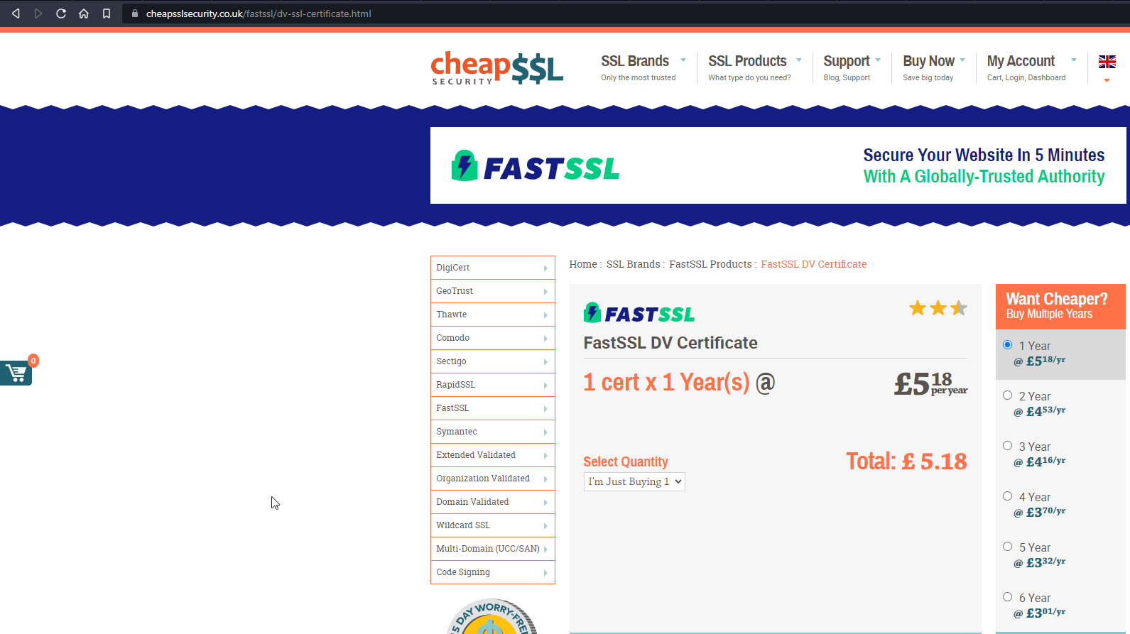

    We could work around this by purchasing a cert elsewhere (relatively cheaply - see below), which would alleviate this issue.
    I’ve used these certs before, and they are trustworthy and work. I’ll also see if I can get the LE certification into a workable state in the meantime. Personally, I’m not a fan of LE as it is problematic to say the least.

    @phenomlab said in NodeBB - Created pages not found?:

    @jac Well, there’s a couple of choices. I now have this working from the CERTBOT perspective, so I think that this will work once the retries counter has been reset. So
    1. You wait until the retry counter is reset (typically next day) then attempt to renew the cert then
    2. You purchase a cert, and not have to worry about it for a year
    Up to you.
