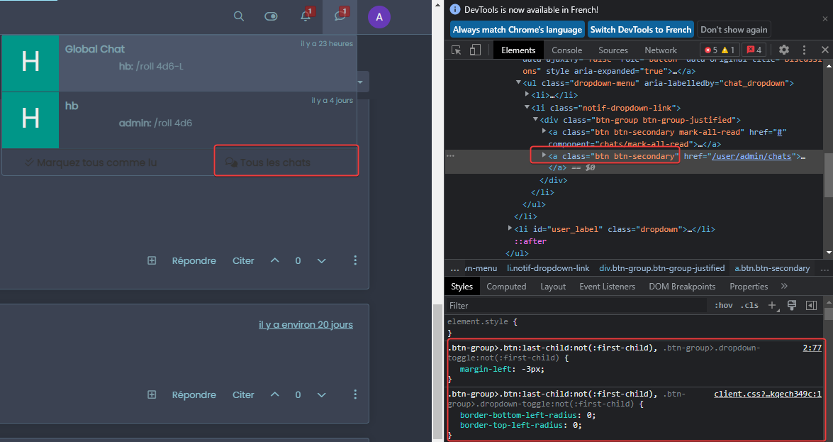

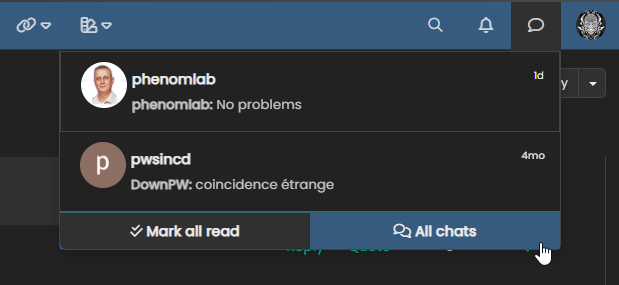

    After upgrade of nodebb 3.2.1, I have small bugs that I can’t solve
    1 & 2
    Can you help me with that ?

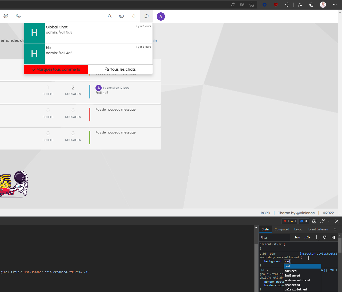

    I search css class and css class hover for new button “Mark all as read” and “All Chats” on chat navbar:
    Thanks in advance

    @DownPW said in chat list navbar:
    Looks like you want to get rid of the border in the highlighted area on the right image, and show the border on the left image ?
    For “Mark all as read” you should be able to target
    btn btn-secondary mark-all-read and btn btn-secondary mark-all-read:hover respectively
    Targeting “All chats” is much harder, as it shares the btn btn-secondary class which is used in multiple places. For it to work how I wanted it, I needed to be more specific in the target, so had to use
    .btn-group>.btn:last-child:not(:first-child), .btn-group>.dropdown-toggle:not(:first-child) {
        /* your CSS here */

    @phenomlab said in chat list navbar:
    in fact I would like the menu not to overflow on the navbar because it was not the case before
    Yes exactly 🙂
    Ah, that makes sense. You can probably do that with a simple margin CSS command. Is your test instance up ?

  • @phenomlab said in chat list navbar:
    Not work with that for example:
    .btn .btn-secondary .mark-all-read {
    	color: red !important;
    .btn .btn-secondary .mark-all-read:hover {
      background: #212427;
    	color: #ccc !important;
    And .btn-group>.btn:last-child:not(:first-child), .btn-group>.dropdown-toggle:not(:first-child):telephone_receiver:
    not too
    That’s being caused by deliberate negative padding. This will fix it
    .chat-list {
        margin-top: 0px;

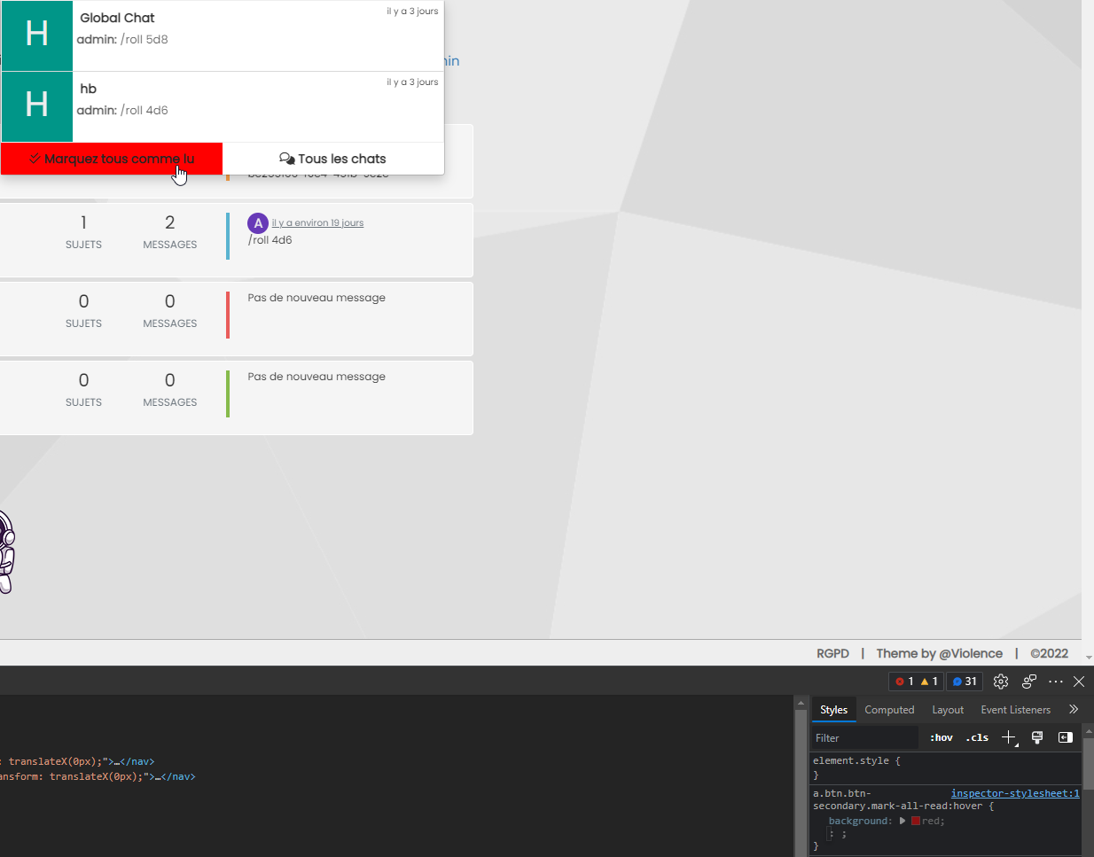

    Seems to work for me on your site, but (sorry), it should be a.btn .btn-secondary .mark-all-read

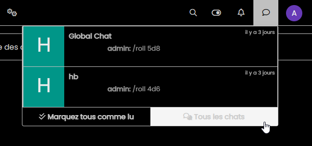

  • yeah great…
    Can you test All chats button hover ?
    Because .btn-group>.btn:last-child:not(:first-child), .btn-group>.dropdown-toggle:not(:first-child):hover not work
  • yeah great…
    @DownPW Works for me ?
  • @DownPW Works for me ?
    Yeah good for “Mark all as read” but not All chats button:
    Yes, sadly, that element is in use in several other places. You could target it directly, but it will also mean changing it in multiple places which won’t be the desired effect. The most effective way would be to target a div ID, but you’d need something like jQuery to target that specific element and add an ID to it.
  • @DownPW said in chat list navbar:
    hmm hard for just an effect.

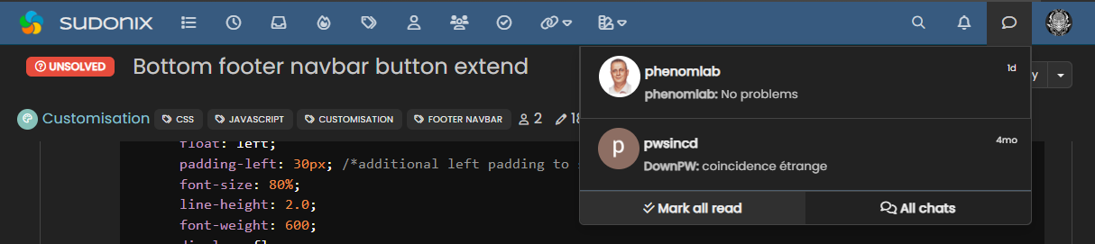

    It’s a problem for my dark themes
    In sudonix I see this :
    and Hover:
    I think it’s a better way, how achieve this effect (with different color) ?

    @DownPW Ah, yes, I remember this one now - it was a nightmare to target, and I landed up using the pseudo class which unfortunately does include the border, but it’s subtle enough to still look good
    Try this
    .btn-group.btn-group-justified:hover {
        /* Your css here */
  • I resolve with this
        color: #ccc;
    a.btn.btn-secondary:hover {
      color: #ccc;
    .caret {
        color: #000;
    a.btn.btn-secondary.mark-all-read {
    a.btn.btn-secondary.mark-all-read:hover {
