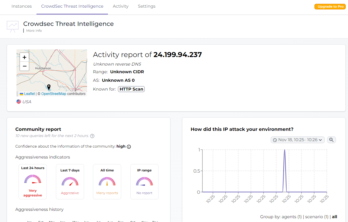

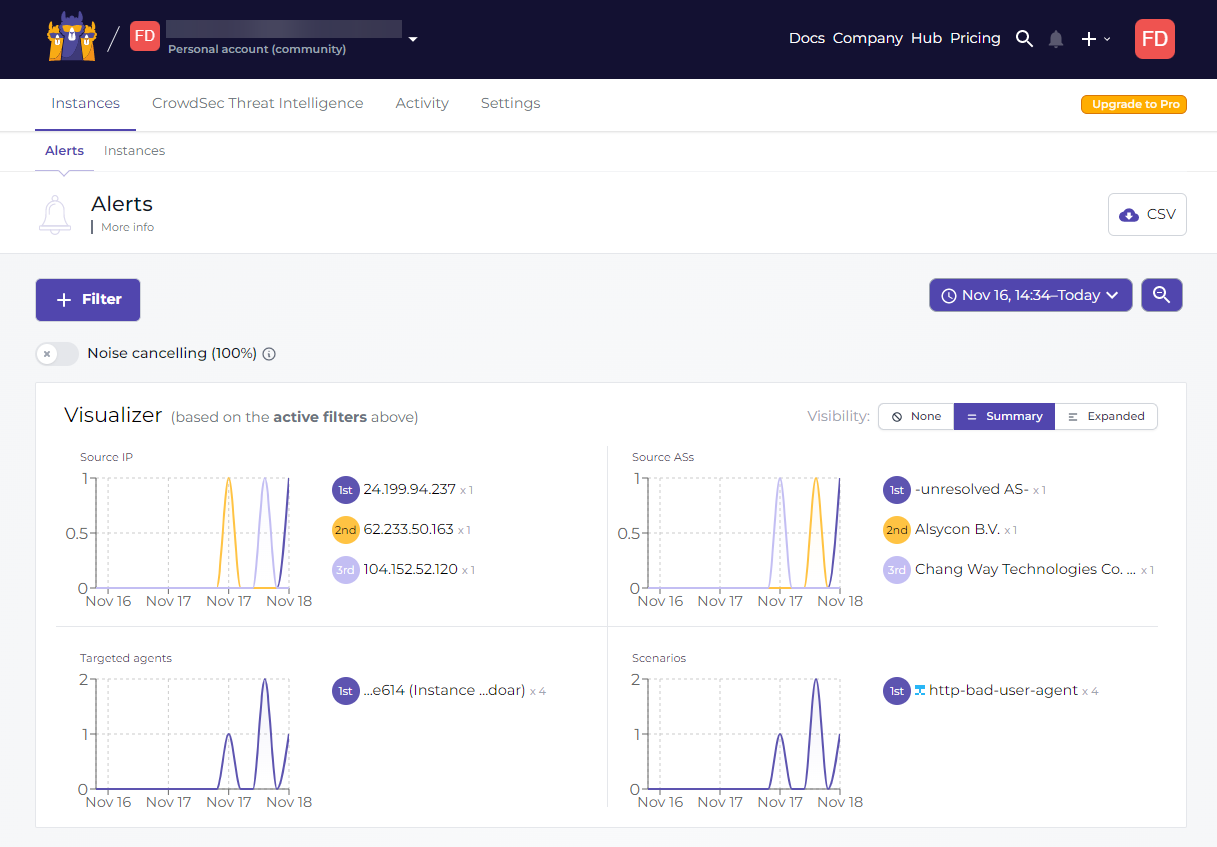

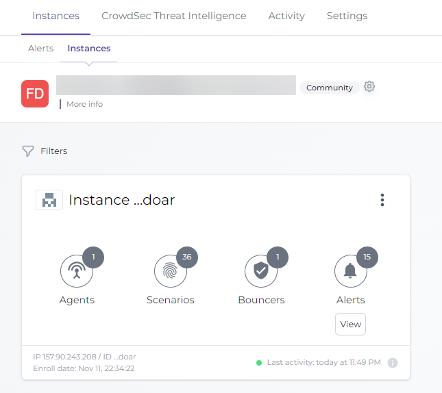

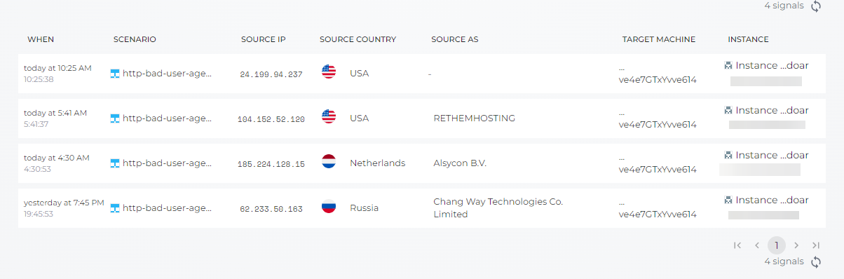

    No they have a free and pro console instance.
    We can see alert with IP, Source AS, scenario attack etc…
    Installation on the NODEBB server without problems. Very good tools
    We can also do research on IPs via the crowdsec analyzer
